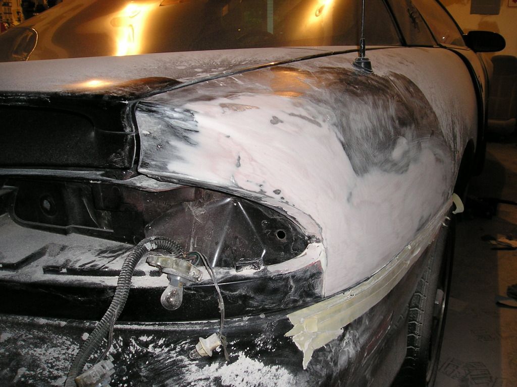

This is what I repaired:

BODY WORK
STEP 1: (note: if you are repairing fiberglass, skip to STEP 2)
First, you need to get the shape of the area as good as you can with the hammer and dolly. Personally, i really didn't use the dolly much, partly because my dent was hard to get to..(Instead of a dolly, i actually used a large punch and hammer to get the contour of the body on the body line for the spoiler). Get it as close to the right shape as you can if access permits. I sprayed it black so you can see how uneven it was because of the limited access of the area.
Closely examine the area that you just pounded out, and make sure there are no high spots. If there are, tap them back in. it's better to be too low than too high.
STEP 2:
From the last step, some paint is probably chipping off from the change in body shape, so pick as much of that off as you can, and sand the rest off. Use the 60 grit paper to sand all of the paint off the damaged area and about 3-4 inches around the damage. For this, since mine was very uneven, i used a Dremel with a sanding bit to get into all the crevices and take off the paint faster.
STEP 3:
Now that you have all of the paint off, you can get ready for the body filler. Clean the area off from sanding dust and any other particles that are on the area. Get the cardboard piece out and open up your tub of body filler. Read the instructions on the tub, and don't use too much filler at a time, because the stuff dries fast, and once it starts drying, that's when the pock marks come in.
Once you've followed the instructions and you have your mixture of body filler and hardener on that piece of cardboard, use the plastic spreaders to apply the filler over the bare area. If the filler starts to dry and starts pocking, STOP. Multiple coats of the filler is perfectly fine, and almost always necessary, so let this coat dry for a good 20 minutes, and try again. It's always better to put more filler on than you need, because you can sand down as much as you want to get the right shape, and on this, sanding moves pretty fast.
STEP 4:
Once you have the desired amount of body filler applied, you can start sanding it down. Use the 60 grit sand paper on the sanding plain to sand the area perfectly smooth and flush to the body, and let the filler 'fade' into the bare metal. this way you won't have any lines or uneven surfaces later on in paint.
You can see that at the time I took these pictures, I had a couple high spots left, where you can see bare metal. I had to lightly pound these back in with the hammer and apply more filler to the areas.
STEP 5:
Now that your filler is smooth and flush to the body, and free of little holes and uneven surfaces, use the 220 grit sand paper to sand the area, feathering the edges of the Bondo, and further blending it into the body. Get all the deep scratches from the 60 grit paper out so it's smooth to touch. ANY and ALL unevenness in the filler will be visible through the paint, so make sure the fill fades seamlessly into the panel, and there are no pocks or scratches.
